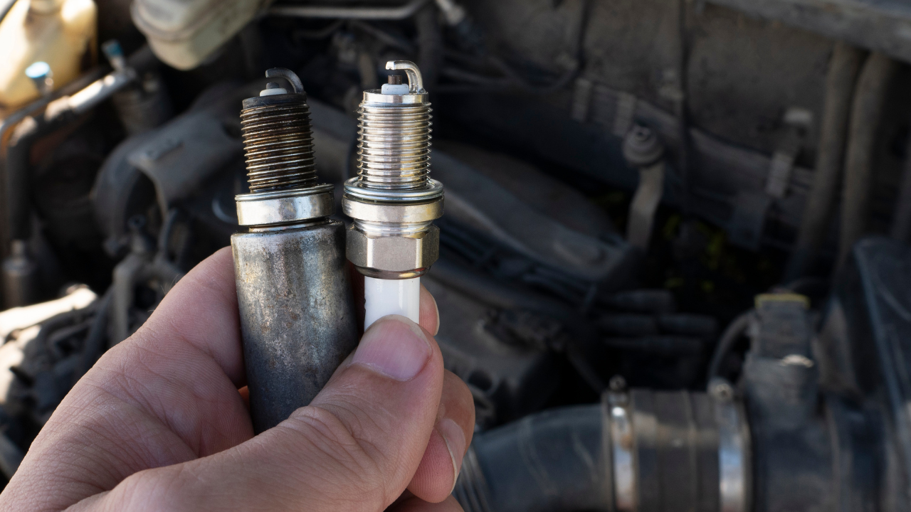

Hand holds worn and new spark plugs side by side, lawn mower engine in background, highlighting replacement need.

Next, use a spark plug wrench or a ratchet with the correct socket size (usually 5/8-inch or 13/16-inch, depending on your mower model). Turn the plug counterclockwise until it loosens and comes free. Once removed, examine the plug carefully:
  • If it’s coated with black carbon deposits, your engine may be running too rich.
  • If it’s oily, there could be an issue with oil leaking into the combustion chamber.
  • If the electrode is burned or worn, it’s a clear sign it’s overdue for replacement.
Keeping the old plug handy can also help you confirm that the new one matches in length, thread size, and shape.
